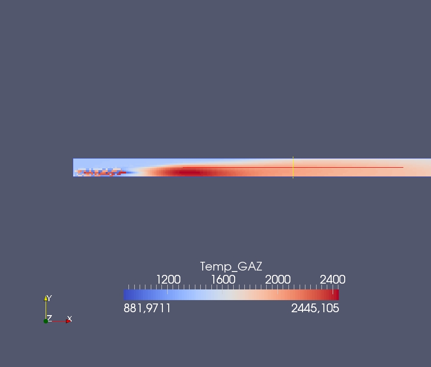

Thanks for the reply. I have another question regarding coal combustion. My solution seems to converge but there are some strange effects concerning the temperature contours (take a look on the attachment). Another thing is that in some cells the total enthalpy falls below zero. The problem appears both with and without radiation model. Do you have any idea what can be the reason? Is it possible that solution domain beeing 2D (cell dimension = 1 in z direction, symmetry BC in X||Y planes) not 3D has influence on this error?
Hi Norbert,
Concerning the enthalpy going below zero, this is (generally) due to the non-respect of the min/max principle at the discrete level. The 2nd-order centered scheme is precise but does not respect this principle, contrary to the 1st-order upwind scheme. So the solution is either to switch to the upwind scheme (for the enthalpy variable) or to clip the enthalpy to zero by minimum values (this might be done by default, I don’t remember).
As regards the temperature issue, this is somewhat weird… I need to talk with the combustion guys :wink:
David
