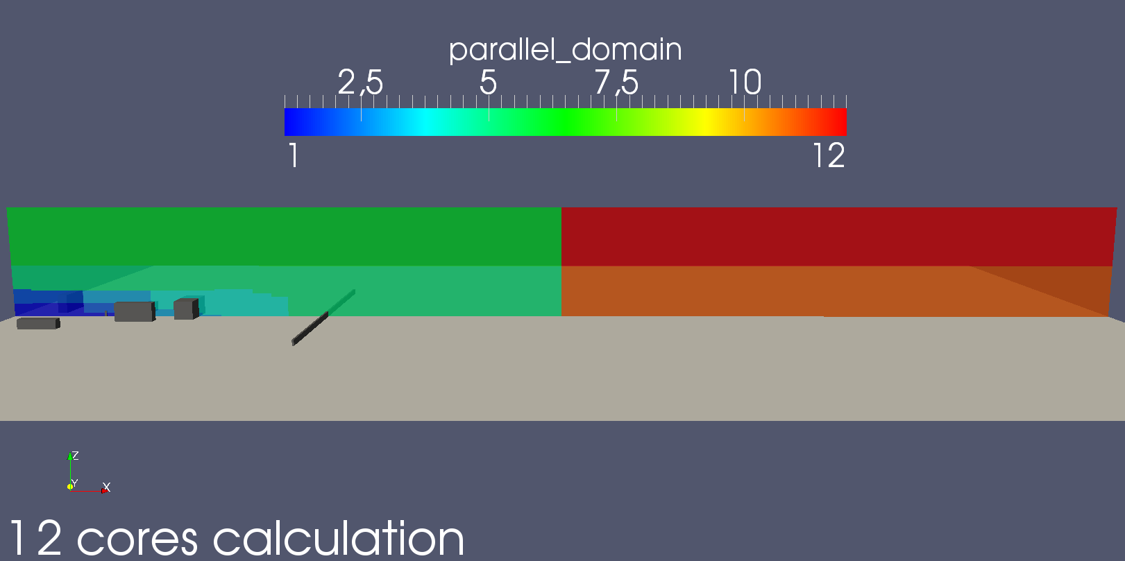

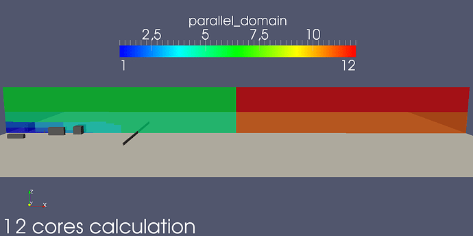

You’ll find attached a picture of what I’m trying to simulate. This is the wind profile after 20 s (for the calculation on a single core and on 12 cores). The profile is not totally initialized yet but it gives a good idea of what I should obtain. I also put a slice of the domain decomposition for the parallel run.
Anyway, thank you for this first advice. I hope my pictures will help finding a solution.
