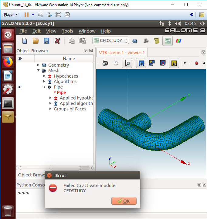

I’m now facing a problem with the CFDSTUDY activation. It is shows an error message like this:
ā€œFailed to activate module CFDSTUDYā€
See attached figure.
Can anyone help me on this?

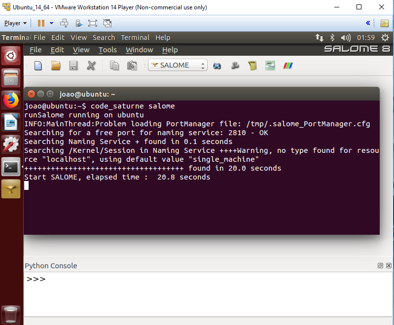

I have have initiated the salome with ā€œcode_saturne salomeā€ on terminal. (I have added a PATH environment to the ā€œcode_saturne salomeā€ file. So i can used anywhere on terminal.)

This is strange, as your configuration command seems fine (otherwise CFSTUDY would not even appear in the menus).
Do you have any logging/text messages in the terminal from which you ran ā€œcode_saturne salomeā€ ?

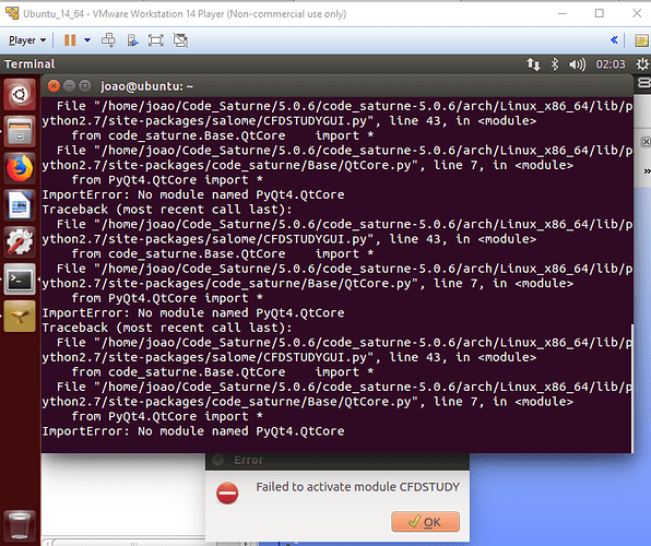

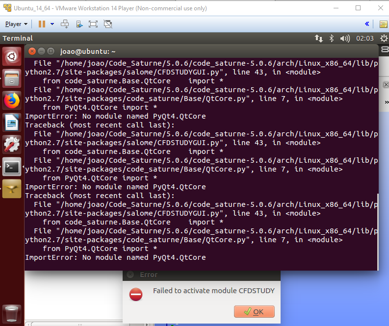

Good morning Yvan,
when i push the CFDSTUDY i have some error messages on terminal window.
I have added some files as attachments.
thanks!
João
log_terminal.txt (3.63 KB)
You might have an issue due to Salome_Meca using Qt5, and Code_Saturne using Qt4.
When both PyQt4 and PyQt5 are available on a machine, Code_Saturne 5.0 defaults to using PyQt4, while Code_Saturne 5.1 defaults to PyQt5.
To force selection of PyQt5, you can add QT_SELECT=5 to the ā€œconfigureā€ line. Otherwise make sure PyQt5 is available, and if you do not need it for othet purposes, uninstalling PyQt4 can help.
Not 100% sure this is the cause of the issue, but the error message seems to indicate of problem of this type, or PYTHONPATH issues.
