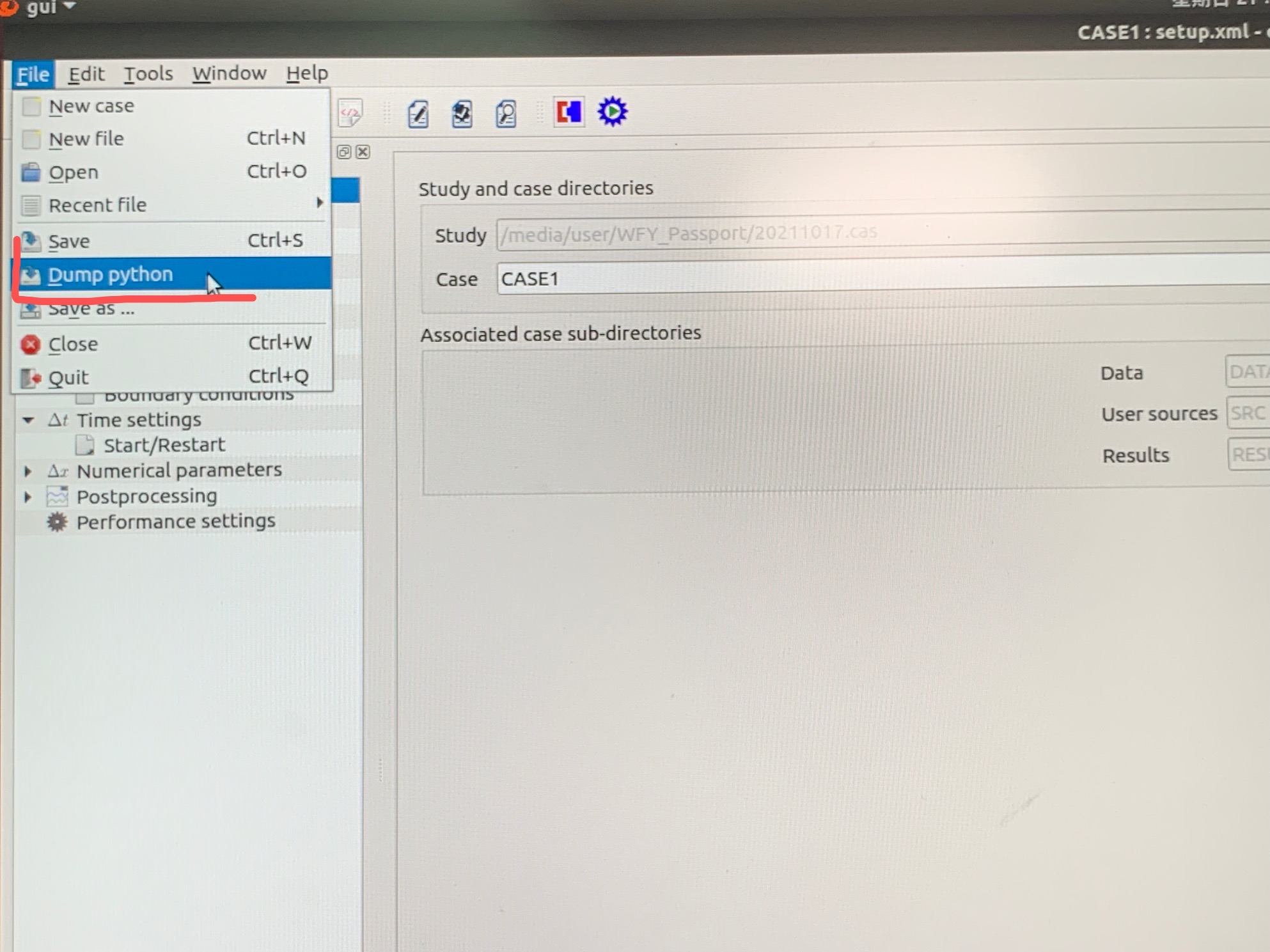

Sorry that I don’t explain what dump scripts are. Here I attached the screenshot.
When I run the dump scripts in YACS, I find that the setting is overwritten.
Maybe it is wrong to link the code_saturne by dump scripts? :confused:

The utility of “dump scripts” is limited. These scripts allow modification of a case’s XML setup, so they may be useful in the following workflow:
  • set up a computation case.
  • dump the Python script
  • adapt commands from this script in cs_user_scripts.py or an external script called by studymanager for a parametric study.
None of that requires YACS. Using YACS, you could also set up a parametric study loop, but there are no current examples to my knowledge. I am not familiar with code_aster YACS scripts, so I cannot compare them..
In any case, the scripts that are dumped by the GUI only manage the xml values. They do not handle the full computation, so need to be included in some other script.

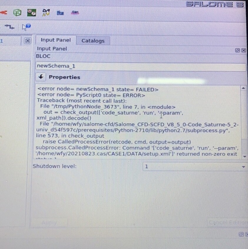

recently I want to run the code_saturne in yacs, but I have tried most times that failed. (whatever in Salome or the Salome-CFD). The screenshot has attached.
I don’t know if my code has wrong?
can you help me? (i just want to run the code_saturne in yacs)
here is my code:
import os
from subprocess import check_output
case_path = ‘/home/wfy/20210823.cas/CASE1’
xml_path = os.path.join(case_path, ‘DATA/setup.xml’)
os.chdir(case_path)
out = check_output([‘code_saturne’, ‘run’, ‘–param’, xml_path).decode()
As a general rule, whenever you have an error message indicating a given process has failed, try to check if you have error messages matching the process in question. For code_saturne, that would be the usual error* messages in the RESU/<run_id> run directory, or if you find nothing useful there, in more detailed logs from YACS.
Without more detailed error messages, I can’t help. With code_saturne alone, I could help you increase logging, but I am not familiar enough with YACS to indicate how to troubleshoot an error under YACS. You might find additional help on the salome-platform.org forum.
