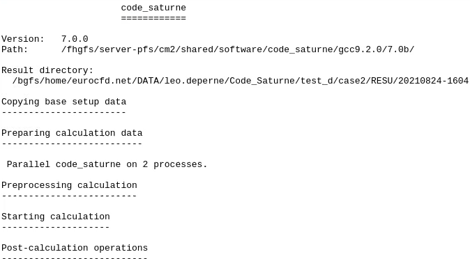

With slurm, I add the “code_saturne.cfg” file and just modified “batch = SLURM”. It works fine on one proc, but nothing on 2 or more.
I have no listing file, nothing written in the error slurm log, and here is what I get on the output log file :
