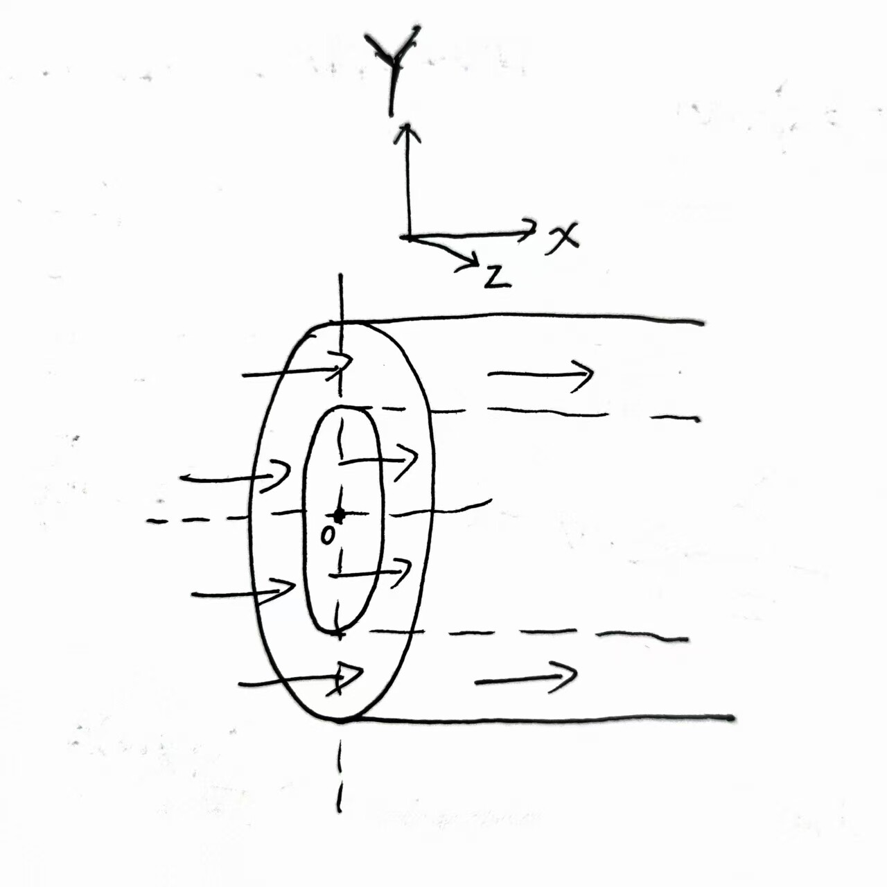

I am currently running an LES simulation (WALE model) of a rotating disk cavity with axial through-flow on a cluster (using MPI). I am trying to impose synthetic turbulence at the inlet using the Synthetic Eddy Method (SEM).
Case Setup**:**
Version: Code_Saturne V9.1
Geometry: Annular inlet (Outer Radius = 0.07m, Inner Radius = 0.052m).

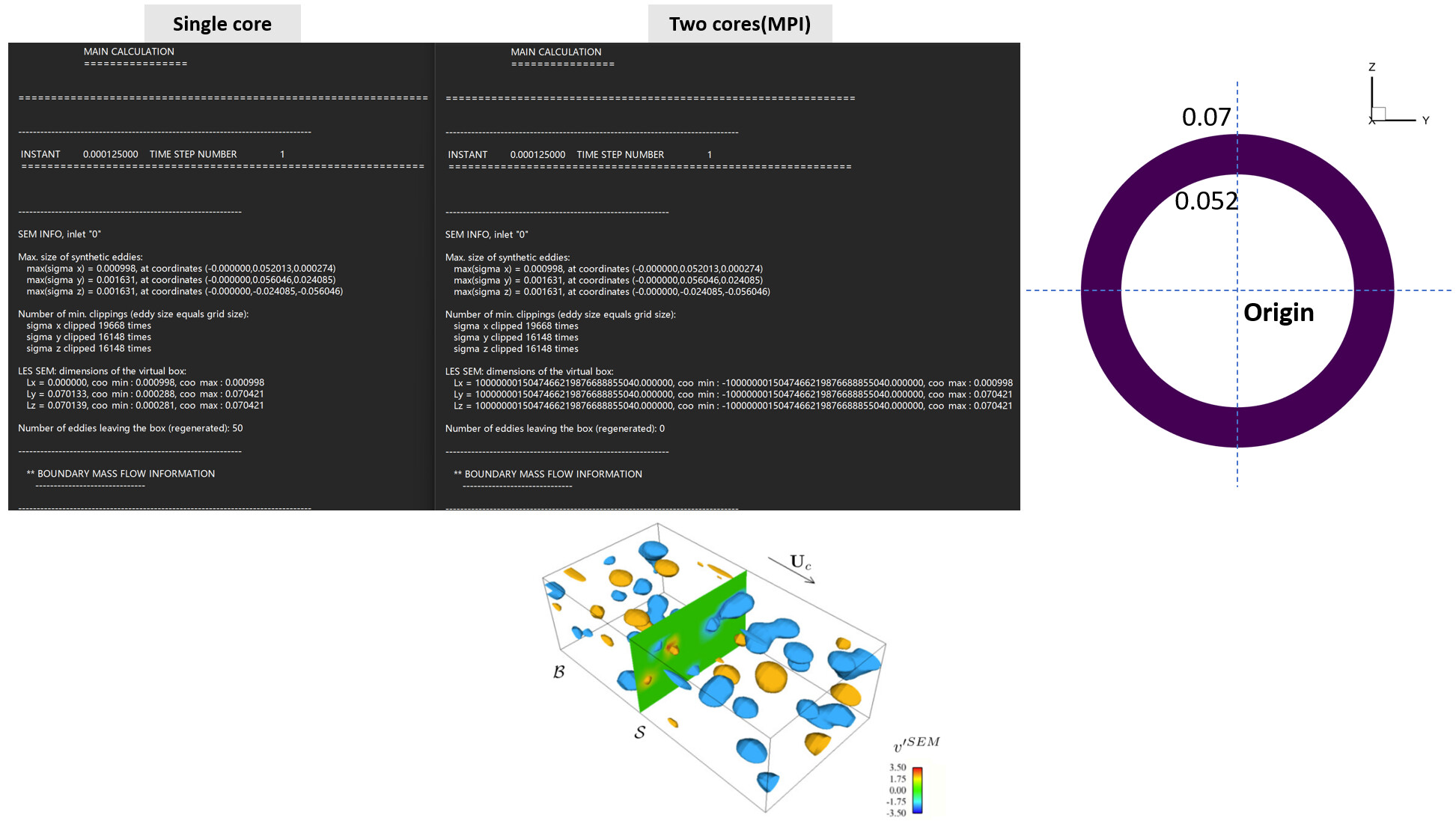

However, the run_solver.log indicates that the dimensions of the SEM virtual box are infinite. It seems the algorithm calculates the maximum coordinates correctly (matching my geometry), but the minimum coordinates (coo_min) are stuck at a negative infinite value (approx -1e30).

LES SEM: dimensions of the virtual box:
Lx = 1000000015047466219876688855040.000000, coo_min : -1000000015047466219876688855040.000000, coo_max : 0.007668
Ly = 1000000015047466219876688855040.000000, coo_min : -1000000015047466219876688855040.000000, coo_max : 0.077651
Lz = 1000000015047466219876688855040.000000, coo_min : -1000000015047466219876688855040.000000, coo_max : 0.077651
Number of eddies leaving the box (regenerated): 0
run_solver.log (356 KB)
I have already tried setting cs_les_inflow_set_restart(false, false) to ensure no old checkpoints are read, and I confirmed that vel_ref is non-zero.
Could this be related to a parallel reduction issue with the bounding box calculation on annular geometries?

I discovered that when I run the calculation using a single core (serial), the “infinite virtual box” error does not occur. However, as soon as I switch to multi-core parallel computation (MPI), the virtual box coordinates become infinite again.
Furthermore, even in the single-core case, the dimensions of the virtual box seem incorrect:
It only covers the inlet area located in the first quadrant (positive Y and Z coordinates), instead of the full geometry.
It has zero thickness in the X-direction (the streamwise direction), showing Lx=0.
I am currently stuck on this issue and would be extremely leaf grateful for any guidance or suggestions.

This seems to be due to an incorrect handling of reducers, fixed in commit 5de8c9.
So updating the code should fix hte issue (v9.1 was released Dec 30, so this is a good option).
