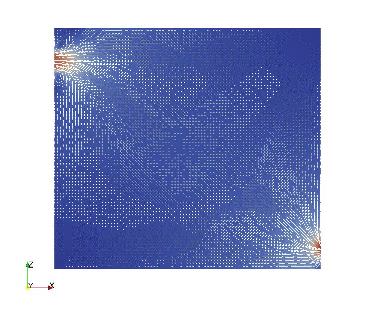

I have a mass flow balance issue in a simple case. My mesh is hexahedral and regular. I put an inlet condition for a number of boundary faces on the up left of the domain and an outlet condition for an identical number of boundary faces on the down right of the domain (see associated picture cas.jpg, color what you see is velocity).

It would seem that you are using cell values, propce, to calculate the mass flow in and out of your domain. I think that you should use boundary face values, variable propfb if I remember correctly. The use of face values should also result in flux2 and flux3 being zero given that your boundaries appear to be aligned with the YZ plane.
