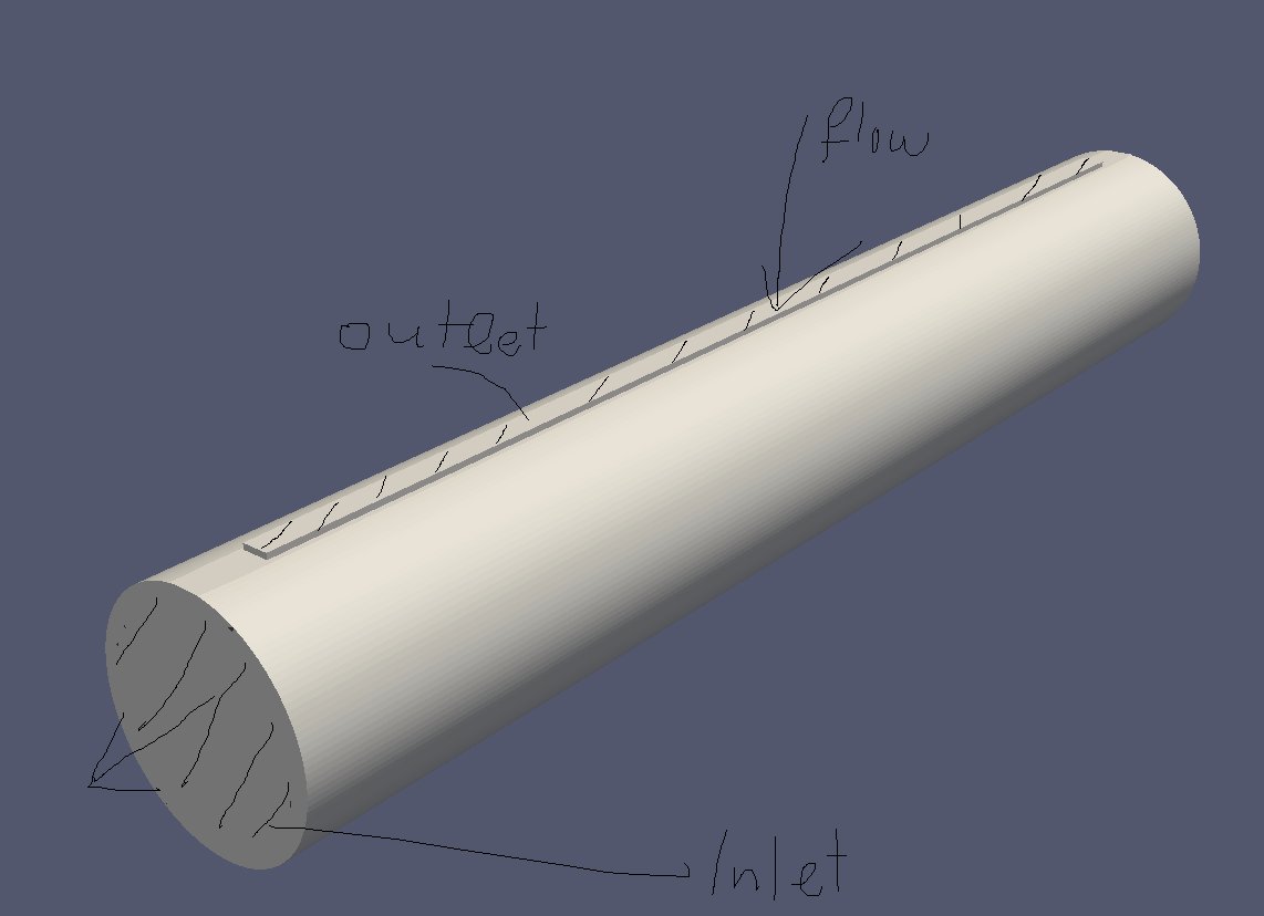

I have a problem with particle tracking. My geometry is actually pretty simple. It is a
My boundaries are set up as followed:
I have a wall, an outlet and an inlet. Thought the thing is, that my inlet is sucking, which means i have a negative volumic flow rate. That is because I only now the exact volumic flow rate at the outlet. When I try to set up the particle tracking it only allows me to define my particle inlet on my flow inlet. So in the calculation it injects 10 particles and immediately eliminates the 10. So I never have a particle in my control volume. I tried to define the outlet as free inlet/outlet but then I cant select the menu for particle boundaries.

I have a transient but not a coupled flow. I only have the boundaries showed in the picture: one of each.
