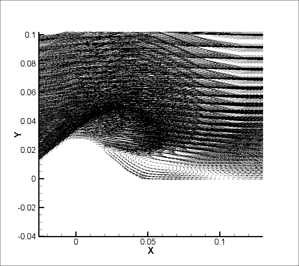

I have simulated flow over a hill. Essentially a 2-D hump.
I have attached some figures for velocity vectors as well.
However, I also want to plot velocity versus y at certaion locations along the x-axis.
Kindly let me know how I can plot it.

One option, if you use the VISU module of Salome Platform, is to use the 2D plot - specify the two ends of a line through your model and choose the quantity to plot. Repeat for multiple line positions. This way you can explore data without necessarily having to write user code.
If you have the data in an easily (or even not so easily) readable file, you have many options - gnuplot, spreadsheet, and no doubt plenty of other plotting software.
