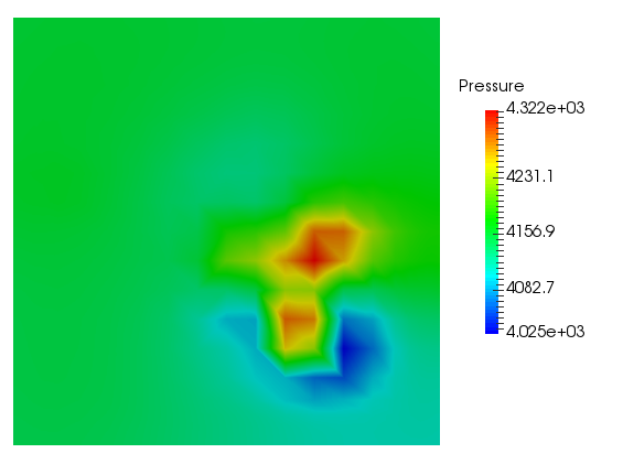

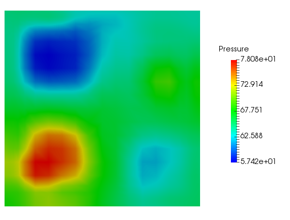

I have carried out simulation using “improved pressure interpolation in stratified flow” as per your suggestion. Now I am getting pressure drop of 4083.8 Pa. But as It can be seen in attached figures flow starts swirling near start of porous region so pressure contour on planes at Z=4.5 m and Z=5.5 m (i.e. beginning and end of porous region) are not symmetric. For simple square duct pressure and velocity contours should be symmetrical. Please suggest possible reason for swirling of flow.

What type of mesh do you have ? Your initial images seemed to show a hexahedral mesh, but your results here would be expected more of a less symmetric mesh, such as tetrahedra. This might also be a side-effect of the “improved pressure interpolation in stratified flow” option, in which case I’ll need to pass this along to colleagues who know this part of the algorithm better than I do.

Hello sir,
I have used hexahedral mesh in whole domain. It is symmetric as it can be seen from mesh images which I have attached with my previous reply.
