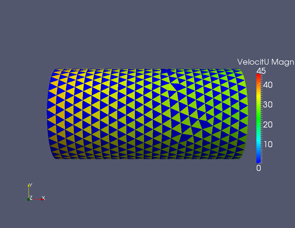

I am simulating a bluff body using tetrahedral mesh. No. of cells is around 1.84 million. I am facing two problems which are :
  1. i am getting strange values on the outer surface of the the computational domain (the blue triangular values in the picture)
  2. Getting very high value of drag co-efficient around 2.7 but i am expecting values around 1.4

Please see the attach pic of the outer surface of the mesh after reaching steady state

I tried the settings u recommended but unfortunately nothing changed … still have the same problem while see velocit magnitude with strange value on the outer surface of the computational domain … may i send u the mesh file … i m using version 1.3.3 .does tht hv some bug or is it i am doing something wrong … ur help would be appriciated .. merci :smiley:
Note that the value you visualize is a cell-centered value. With a tetrahedral mesh, some cell centers are closer to the boundary than others, so depending on the thickness of the boundary layer, what you see may be quite normal.
You may “smoothe” the visualization using ParaView’s “cell data to point data” filter or EnSight’s “ElementtoNode” calculator function.
If the result is still irregular, you may have an issue with the calculation. Otherwise, it is mainly a visualization issue.
In any case, having one or two prismatic layers (extruded triangles for example) at the boundary whould help both visualization and calculation quality, so if your friction coefficient is very far from what you would expect, improving the mesh (or at least doing some refinement for mesh sensitivity analysis) would help.

Thnx for your reply. your suggestion really worked for visualization worked… i changed cell data to point data nd i see no problems. But for the friction co-efficient i still need to find out… i will update you about it…
