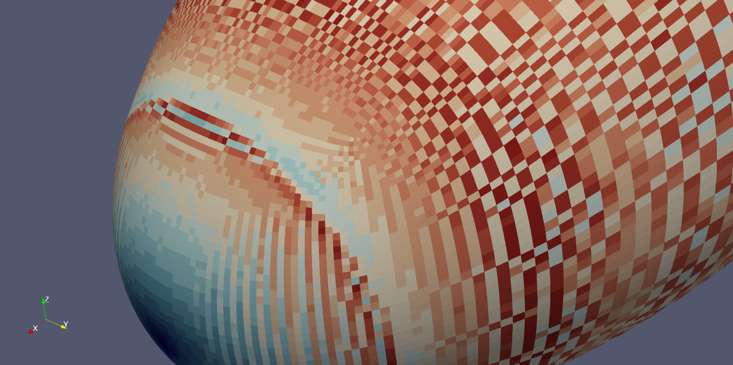

shear stress is checkboarding
I am using CS 4.2.1 for a computation at Re 1e7.
My mesh is block structured, very good quality (it’s not mine, so it is not self satisfaction :stuck_out_tongue: ).
Y+ average is 0.75 so i use k-w without wall functions.
Flow is incompressible, no thermic, with objective to compute drag on body.
I can observe that the wall shear stress (field Shear_Stress) has strange behavior (checkboarding effect, see attached picture).
I would like to know if any of CS users or developpers have already faced this problem and what could be the cause of this patterns ?
Could it be a post-processing problem or bug ? (My overall forces (pressure+shear) on the wall are correct regarding to other CFD codes)
Thanks for any help.

I am visualizing the field Shear_Stress defined in the output for boundaries of type wall
a bug in the z-component of the boundary stresses
I was thinking of that, but the x and y component are also checkerboarding…

So far what i’ve done :
I made a restart of my 4.2.1 computation with v5.0 beta version and with just one iteration to see if it was only the post-processing writing that was messed up. But the problem is still there.
I queued a full computation with v5.0beta for the week end to see if results are different.

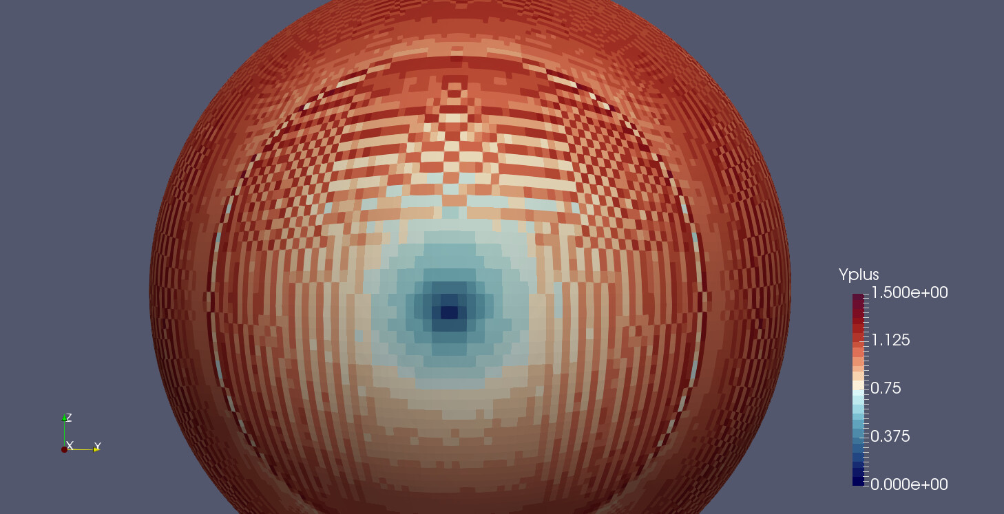

Pressure field looks good, Yplus shows the same checkerboarding effect than wall shear.

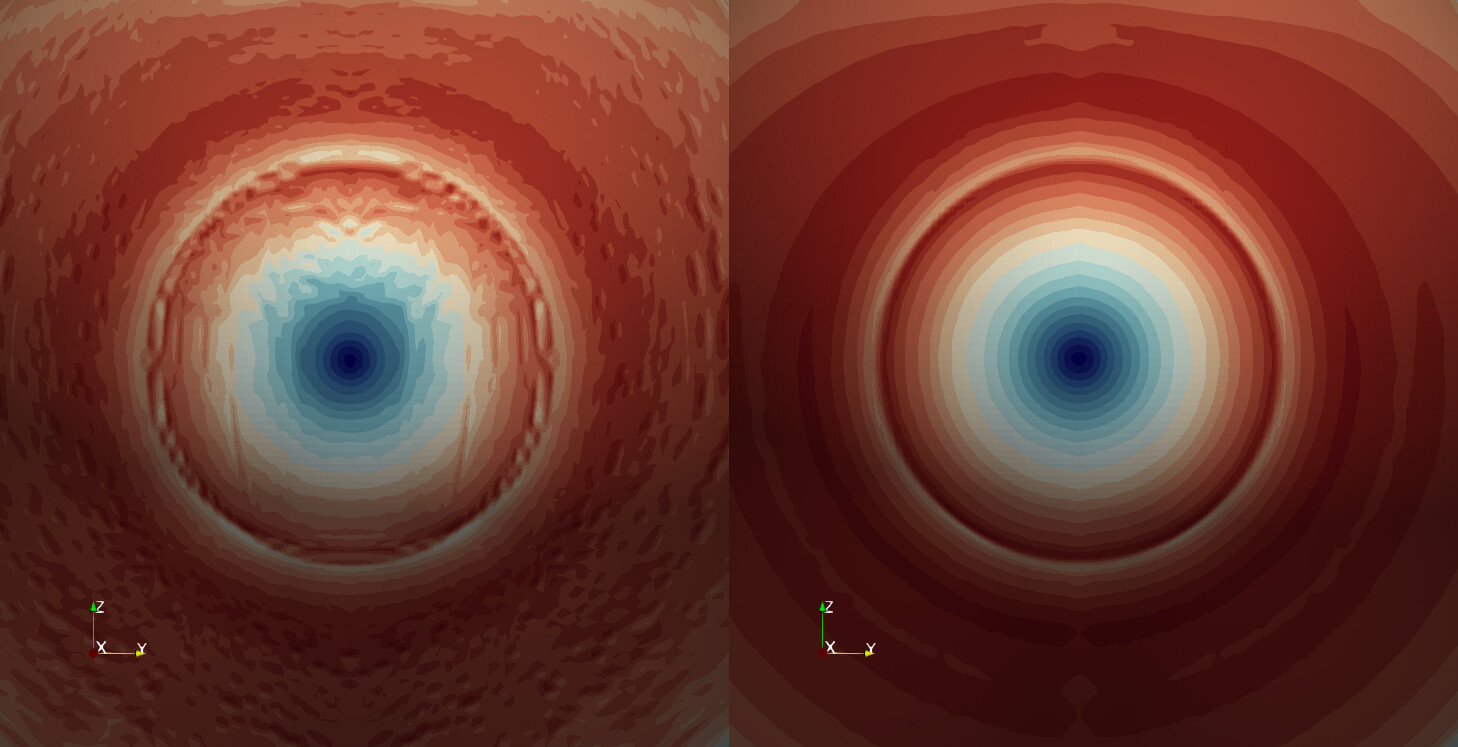

Could you try also using a “cell data to point data” filter ? This is generally useful for tetrahedral meshes, where we can observe “false checkerboarding” due to the cell centers being a a different distance from the wall for neighboring cells, but this should net be the case according to the way you mesh was built… Unless your y+ values are out of the valid range for your turbulence model.
Yes, it slightly improves, but for pure Hex structured mesh, i didn’t expected to need this. And still with this filter, results does not look as physical as it should be (see attach picture comp.png with comparison for “cell data to point data” filter for cs (left) and other code (right)

what values of y+ do you obtain ?
typically around 1 where checkerboarding is observed (see attached picture)

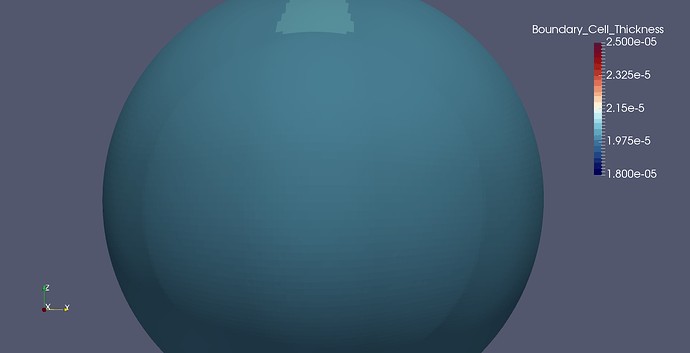

visualizing the boundary cell thickness
see attached picture, no checkerboarding seen at this level
