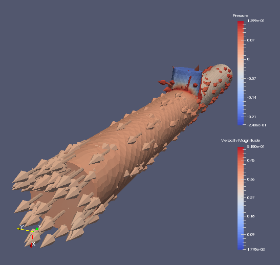

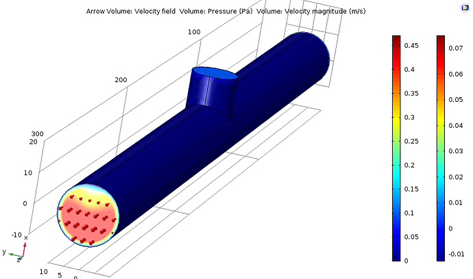

To compare a 3D laminar flow case, I calculate the same problem with CS and Comsol.
The geometry consist of a tube with 2 inlets ans one outlet.
It is strange to me that the velocity is not null on the boundary (BC=Wall) with CS. Maybe it is a problem of post processing with paravis I visualize only the fluid domain?
I join pictures.

Yes, the velocity that is visualized for Code_Saturne is actually the velocity at the cell centers adjacent to the boundary.
For scalars, we have recently added the possibility of visualizing boundary values on the surface mesh, but for velocity, we do not have this option yet.

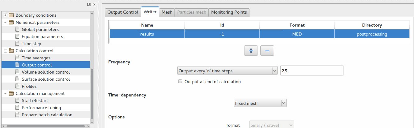

Yes, you can select the frequency of the output in the writer tab on “Output Control”.

I attach a screenshot about where you can set the output frequency.
Luciano
I’ll also add that using the MED format, multiple solutions are written to the same file, so you need to open it to check how many time steps it contains.
