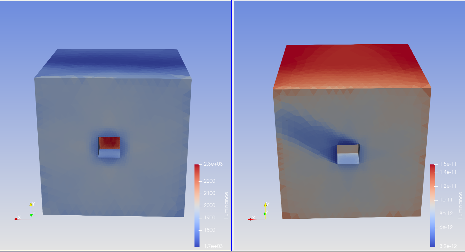

I add a screenshot of the two compared cases (on the left, the 1D model is activated, the luminance has the right magnitude, on the right, the solar charge is activated without the 1D model, with a bad magnitude but a good solar direction). If anyone understands how to set parameters in order to have both benefits? I tried to understand atr1vf.f90, and it seems that enable 1D radiation means to have a vertical solar radiation.
I am still wondering how to impose Solar Load with zenith angle, does anybody know how to do it ?

Ok, I’ll check with Martin when he is available. If I remember correctly, fo the atmospheric model with solar radiation, it is assumed that the direction of gravity is -z, and ground in the XY plane, at least when flat, so there is a difference in handling of downwards (direct) and infra-red terms. This still involves the DOM model (with different directions), but optimized relative to the expected dominant wavelenghts. I am not quite sure about more advanced details for solar direction though.
Thank you very much ! Any form of help is welcome.
Yes indeed, I think I saw this difference, if i rember well, the former is computed rayso.f90 while the second one is computed in rayir.f90.
Is the direct radiation automatically directed downward ?
