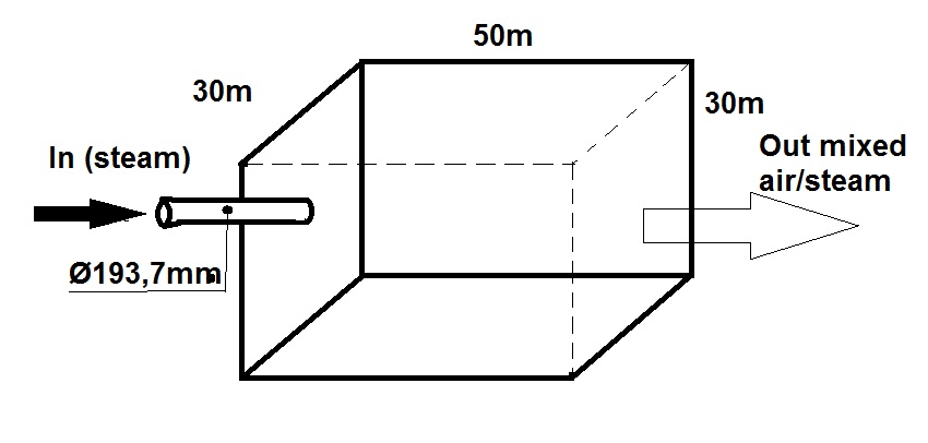

I found the following error in the listing. I understand it is because i have 17 outlet faces, i only have a box *30x30x50 meters with a tube sticking in diameter of the tube is 194mm.

What i want is to see temp. i the steam cloud and see how this cloud develops (distance, and size). I now first started with what i thought would be a simple model to get me started and get some indication on the results so i can adjust my calculation more later on.
Temp. of the steam is 500degC and 70Bars. Furthermore i don’t know i Code-saturne i capable to give usefull results, but according to what i have seen will the program be usefull for this type of model.

My initial temperature is 500degC (temp. into the pipe).
My end temp is assumed to be 20degC (temp. out of “the box”).
I expect that the temperature and speed of the steam has mixed with the air at that point so no steam will go though the far wall.
My max temp. is 500degC at the pipe into model. my lowest temp is 20degC in the model. Do i need to create this in an other way?

You should not define any heat flux for your case.
  • The outlet (right on your figure) should be a free outlet (otherwise, you need to activate the compressible model, which works in version 2.0 and 3.0-rc1, but not in 2.2 and 2.3)
  • The sides should be adiabatic (zero heat flux) walls
  • At the inlet, the temperature should be a fixed 500°C (the initial temperature in the domain being 20°).
At this stage, you don’t need an additional scalar/species, but you can start adding one, with 0 initial value, and 1 at the inlet, to define the steam fraction. You’ll need it when you want to define variable physical properties, which will depend on this ratio.
