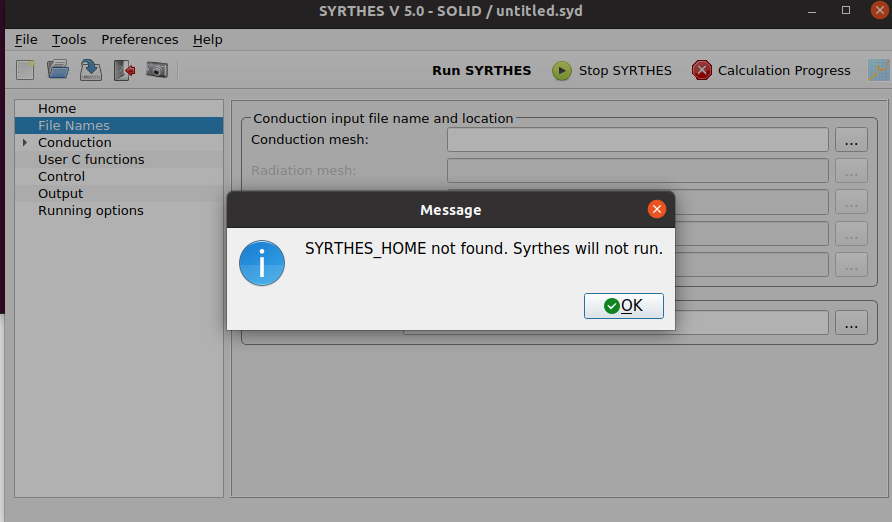

Then, launching the syrthes_install.py program leads to errors explained in the syrthesconvert.log (attached), but it seems to be ok so I finally decided to launch the GUI anyway, and to test the 3D_2D_DISKS tutorial. At the step of adding the mesh, the following error appears:
I have obviously sourced syrthes with xx/bin/syrthes.profile just before, so the env variable SYRTHES_HOME is /home/sim/syrthes/syrthes5.0/arch/Linux_x86_64
I suspect a problem with my gcc version (which is 4.9)… Is syrthes 5 compatible with Ubuntu20 ?

Regarding the GUI, you should check the previous thread and its solution, which seems very similar: https://discourse.simvia-app.fr/t/syrthesmpi-error-end-syrthes-gui-with-python-error/2185/1
Otherwise, for coupling, here are a few solutions :
  • If you really need the features in Syrthes 5 not in Syrthes 4, then you don’t have much choice except pursue this approach (I know about some additional radiative model approaches, but am not sure those can be coupled with code_saturne, and have otherwise not seen anything resembling release notes).
  • If Syrthes 4 is enough, the version on this web site (https://www.code-saturne.org/cms/web/download/prerequisites) should be easier to install (at least for the GUI).
  • If you do not need the transparent medium radiative model from Syrthes and do not need setting contact (material interface) resistance values, the internal coupling in code_saturne can be used instead. If you computation domain is mostly solid, that would make the computation more expensive/slower, though. If it is mostly fluid, that would be about as fast, possibly better (depending on load balancing). And it is easier to set up.
