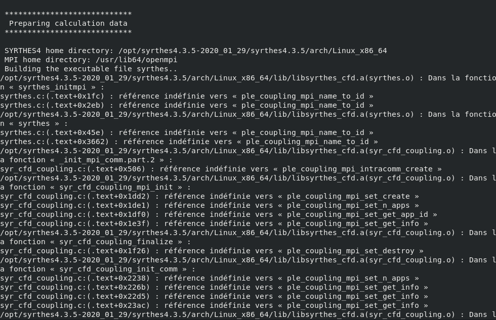

When my user tried to make a coupled simulation, the directory creation works, GUI interface also but we have an error when we launch runcase (see picture attached).
Vincent
Was code_saturne and PLE installed with MPI support ? This is necessary for the Syrthes coupling.
Indeed, there were a bad path in one of the config file.
Now the previous problem is solved.
Syrthes simulations work for mono or multi procs.
Saturne simulations work for mono or multi procs.
But coupled simulation doesn’t work.
Any idea why we face this cs_syr_coupling.c:898: Erreur fatale ?
