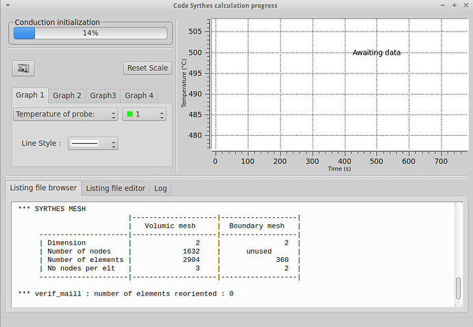

I have the exact same problem.
In listing file:
*** SYRTHES MESH
                           |   Volumic mesh     |  Boundary mesh   |
      | Dimension          |               2    |               2  |
      | Number of nodes    |            1632    |      unused      |
      | Number of elements |            2904    |             360  |
      | Nb nodes per elt   |               3    |               2  |
 *** verif_maill : number of elements reoriented : 0

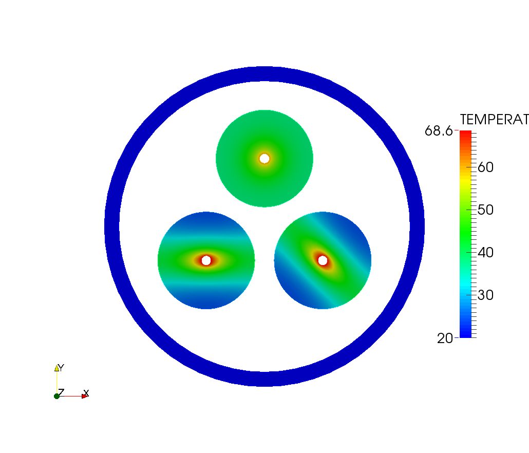

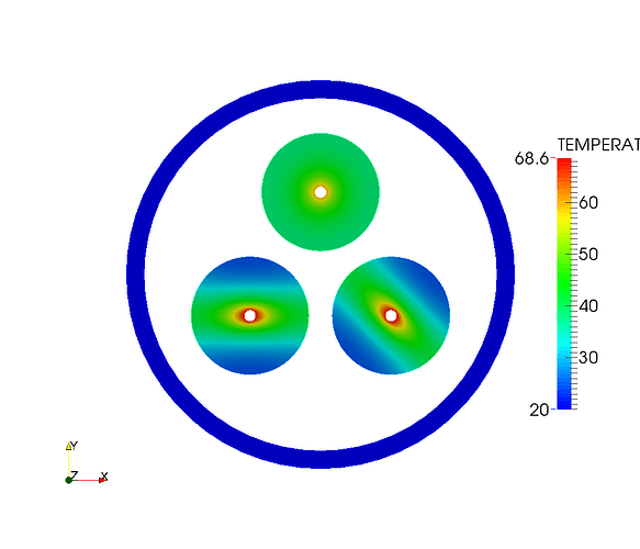

I’ve used the files that you have uploaded to set up your case on my machine. However, it doesn’t run for which reasons it is not clear. So, I set up a new case using the mesh that you supplied. This runs okay and gives results of the temperature distribution in the three discs. The attached file contains the run on my machine which is using Syrthes V4.1 and Ubuntu 13.04.
Can you please try this case on your machine and let me know what happens.
Brian Angel.
With the files this time.

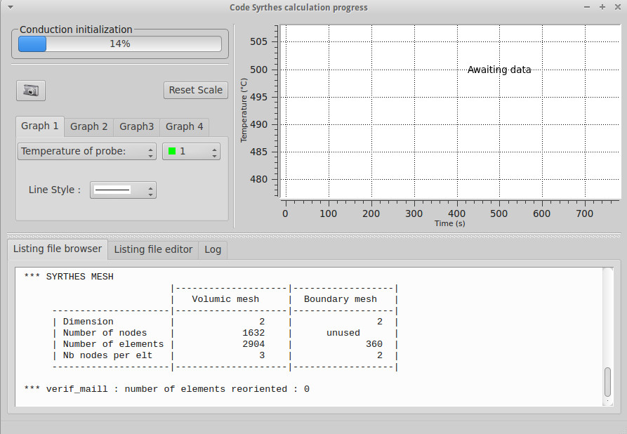

Hello:
I ran the syrthes.gui command opened the file you provided and started the run. The progress bar stops at 14% as shown in Clement’s screenshot.
I killed the run and closed the gui. I ran the command line which was echo’d from the gui run:

==57075==    by 0x401611: main (in /home/stefan/test/3disks2D/solid/syrthes)
==57075==
==57075== LEAK SUMMARY:
==57075==    definitely lost: 16 bytes in 1 blocks
==57075==    indirectly lost: 0 bytes in 0 blocks
==57075==      possibly lost: 0 bytes in 0 blocks
==57075==    still reachable: 198,709 bytes in 35 blocks
==57075==         suppressed: 0 bytes in 0 blocks
==57075== Reachable blocks (those to which a pointer was found) are not shown.
==57075== To see them, rerun with: --leak-check=full --show-leak-kinds=all
==57075==
==57075== For counts of detected and suppressed errors, rerun with: -v
==57075== ERROR SUMMARY: 2 errors from 2 contexts (suppressed: 1 from 1)
Segmentation fault (core dumped)
My best guess is that the memory is leaking pretty badly in one of the routines as it eats the entire stack.
Stefan
Hi stefann,
I had the same “stuck at 14%”-problem in my first steps with SYRTHES, until I recognized the choice of partition control. In syrthes.gui I had to choose “METIS”, because “SCOTCH” did not work for me.
Perhaps this is only a small hint, but I simply decided to write this because of the 14% :wink:.
Cheers,
Christoph
Thanks for the suggestion. I gave it a try but I still get a segmentation fault when I run regardless of which domain partition option I choose. I am running with 1 processor so I am not sure it uses any domain partitioning.
Stefan
Hi,
I ran into the exact same problem, I recently installed syrthes 4.1.1 and was following tutorials to get used. Did anybody find out how to proceed? If it can be of any help, the progress bar value reached before error varies with the number of processor used (e.g. 1cpu=14% 2=35% 3=71% 4=92%).
