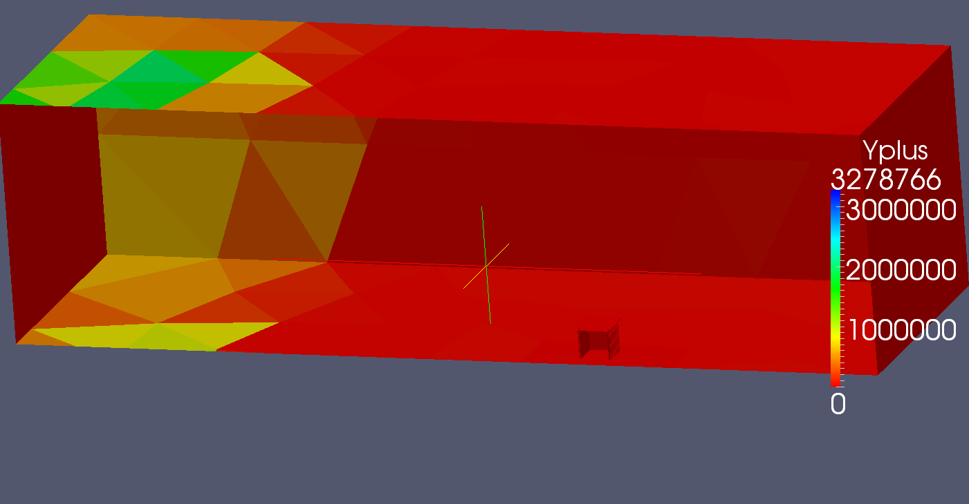

Hi thank to you all, I finally was able to get the y+ value. I post the image of my domain.
I’m running a steady flow simulation with an inlet velocity of 2m/s.
My inlet is on the right side and the outlet on the left. It seems that all the part on the right has a y+ value under 1! Am I so far form standard value of 30<y+<100 (as Cèsar said to me)?
My problem is that I’ve already coarsen my mesh without any good result. I think that the problem could be the little dimension of my ventilated facade in the building (5cm) compared against the entire domain, so I think I should simplify the model…but I’m afraid to get too much approximated data in that way.
I’ll try to explain better…I’m making this analysis in order to find the pressure coefficients induced by given wind conditions, for the air entering in the ventilated facade and, being the fort time i facing such a problem, I don’t know if considering the ventilated facade as a unique body instead as group of separated elements, rather than taking the flow laminar could affect in an important manner my results.
If anyone has experience of such analysis could give advices about to overcome the problem?
Thank you for your help.
